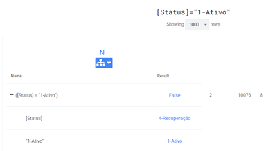

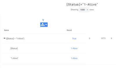

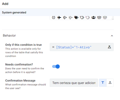

I'm tryng to show the action button ADD only when the Status column is equal to "1-Ativo".
When I click on the test button, it even shows Yes or No on the correct rows, but when I access the application, the button simply does not appear in any case.
All tables are enabled to add, update and delete. And the slices have the actions.

The add action is not a "row-level" action. That means it does not run in the context of a single record, but is instead context-less. So it has no idea which record you're wanting to compare the status value from. You'll need to provide more details if you need a suggestion on how to proceed.

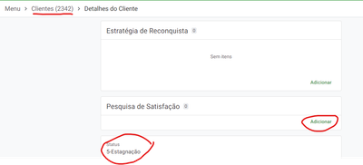

I have this table called "Clientes". In this table there is a field called "Status" and a ref field to another table that show all the related "Pesquisa de Satisfaรงรฃo". So I need the action button to appear only when the Status is equal to "1-Ativo".

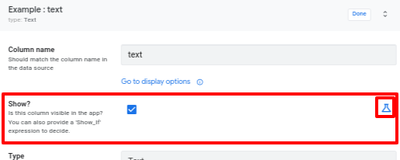

Where are those part I can find where to set that conditionality..
to be more complete the subform or sublist are generated by the systems and there is no way to formulate the conditionality
