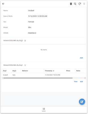

What is preventing you from seeing the doglink from dogB? The [dog2] column is a Ref column, right? Then there should be a [Related doglink by dog2] column in the dog table.

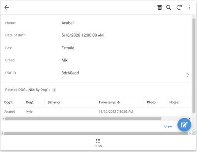

Here are the two inline views when observed from Dog A and Dog B

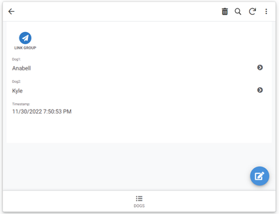

Here is the Doglink view that I can only view from Dog 1

Right, so from Kyle's record, you'd see the same doglink in the inline view associated with the [related doglink by dog2] column. You aren't showing that inline view in your screenshots, do you not have it visible on your dog_detail view?
Good evening. Gaining some headway here. So one of the ref virtual colums was not checked. I can see the connection from both profiles now. However, how do I set it up so that I only see one inline view instead of both?
