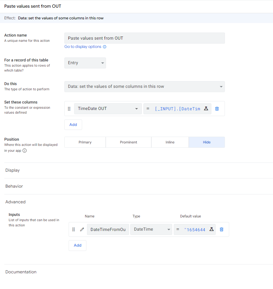

Trying with only one [_INPUT], in this case
Set a new INPUT as ->  Name: DateTimeFromOut  //  Type:DateTime  //  Default:"165464465" (a random number)
SET COLUMNS ->  Entry[TimeDate Out]=[_INPUT].[DateTimeFromOut]

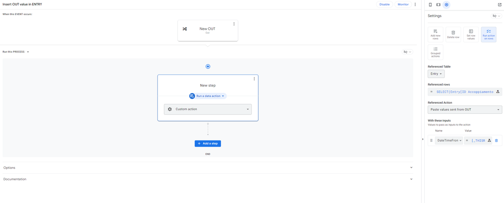

The following is the Automation:
Triggers every time a new ROW is added to the table "OUT",
The first step of the action RUNS ACTION ON ROWS in the table "ENTRY"
The referred row is selected by SELECT(Entry[ID Accoppiamento],[_THISROW].[ID Accoppiamento]=[ID Accoppiamento])
(ID Accoppiamento is the Italian for PairingID I was referring to above).
The ACTION associated is the one explained above.
The defined INPUTS are:
- DateTimeFromOut = [_THISROW].[TimeDate OUT]
Still can't find the logic error.
Thank you in advance everyone!
Everything seems OK.
What results are you getting if any?
Any clues in the Bot monitor log?
The test of the bot reposnd this wor ACTION 1
Failed: 'Execute an Action on a Set of Rows' Data action 'New step Action - 1' for table 'Out failed with exception Cannot get key values when Parent or ChangeImage are null.
Since  [PairingID] is the field connecting rows between Entry and OUT, you want to use
SELECT(
 Entry[key column],
 [ParingID] = [_THISROW].[ParingID]
in the reference rows setting:
