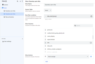

Here you can see my slice:
Can it be because of any columns I choosed to slice? :s

About the actions, i have included ALL and even included  Auto Assign in the last one, as you can see on the screenshot
