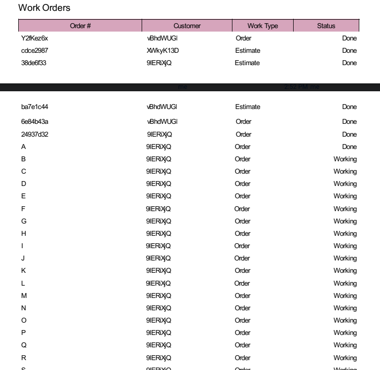

@Iling_Yeh I was intrigued by your question and decided to try. There is, of course, the Report options in AppSheet but I will assume you want an adhoc report generated off of some trigger (i.e. Workflow).
This is indeed possible by using the <<Start: >>/<<End>> syntax and inserting a SELECT() statement. For example, I added the block below to a template I already have and it produced the list of Work Order info shown in the pic.
I hope this helps!
Block Added
Result in File (spans onto second page - reason for black line)
