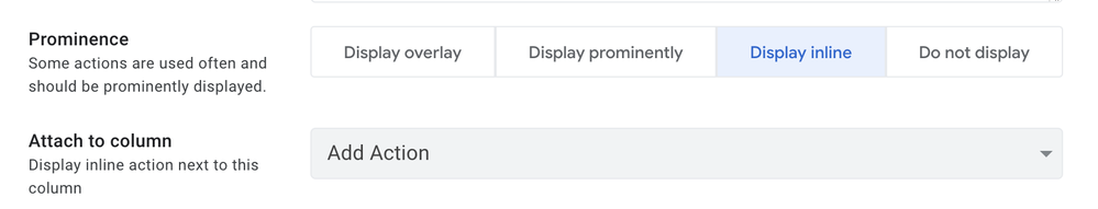

What you CAN do is add an Inline action where each row has its own button in the Table view. Something like purple button in the image below:
To do this, you would set the action to Display Inline and then attach it to a column. The Table View will then replace the normal value with the button.
If you wish to still show the column value in the Table view as well, then you can create a dedicated column for displaying the button. In the image below, [Add Action] is a virtual color I use to solely attach the button to. Then I can show the [Add Action] column in any Table views I wish to have the Add action button appear.
