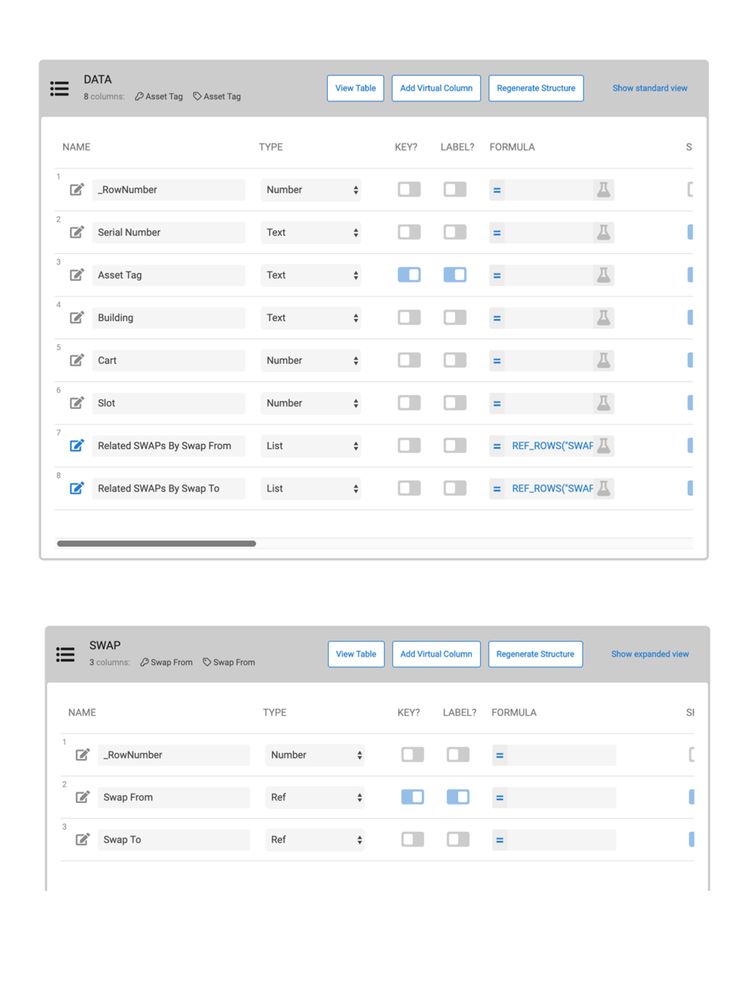

Thanks for your answer, and it sounds like that is a logical way to go… so Swap record would essentially be another table that uses Ref fields to pull and then push?
Correct. A new table that has the columns Swap From, Swap To and then any other data you want to associate with the swap action. This table basically becomes your “variables”.

Still struggling with the setup of this… my logical workflow is this:
Look up an inventory record (FROM) + hit Swap button…
  • Look up new inventory record (TO)
  • Change data of a TO record’s columns to be the value of FROM
  • Set value of FROM record column to blank
In the real world, I have a device with Building, Cart, and Slot number and need to replace it with a new device… the new device will have the updated Building, Cart, Slot number and the old one would be blank in those fields
All of my data lives in a single Google Sheet’s DATA sheet, with SWAP sheet being where the SwapFrom and SwapTo columns live.
Did I connect these properly?
How do I reference the SwapFrom record in an Action…meaning, what’s an example of the syntax where I reference a table/column?
Thanks again!
Brian, I apologize for the delay. I got busy and then when I started to reply, I realized my approach might have been overly complicated for your needs. It was based on a more complicated use case I developed last year for splitting an inventory item into two or more other inventory items.
I didn’t want to lead you down a rabbit hole so I created a little tester app to prove out the functionality. Typing out the instructions will be unwieldily so I can instead just transfer ownership to you so you can look at how I put it together. I would need your AppSheet ID and email to transfer.
The main gist is I scrapped the Swap table. Instead I added a Swap From column to the Data table. It only shows when a Swap is performed. Using a Swap action, the Swap view is automatically populated with the Swap From record and the Building, Cart and Slot fields are automatically initialized based on the Swap From record. There are other ways.
Once the “swapped” record is saved, a Workflow rule is triggered that calls an action (set of actions actually) to clear the fields from the original Data record that was swapped from.
Let me know if you’d like me to transfer the app to you or if you have any other questions.
By the way, I meant to add this before, by introducing a Swap object/row into your data set, you will then have the capability to “remember” what was swapped and perform UNDO functions later. If values change after the Swap is done, you might need to record the specific values used during the swap but you now have the mechanism you can expand to add that “memory”.
