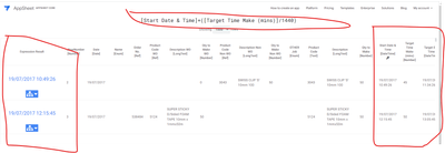

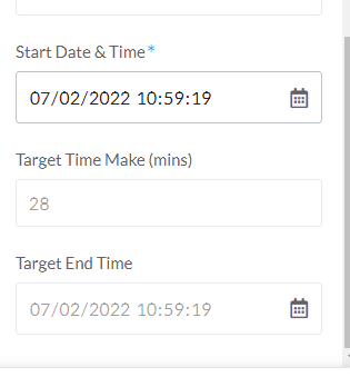

Add Number to DateTime
I'm trying to add a minutes as a Number to DateTime.
On the app the result shows the same as the Start Time.
When I test the expression the expression result shows the same as the start time, but the column for the result, Target End Time is calculating the correct DateTime with the added minutes
Calculation
[Start Date & Time]+([Target Time Make (mins)]/1440)
0 18 1,135

Apparently when you add an integer to a DateTime value, it is taken as the number of Days. So if you divide you Mins column by 1440, it is less than one day.
If you want to add minutes to a DateTime you have to add a Duration.
