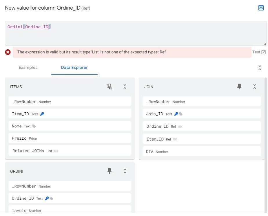

The "add Product to Order" action requires the columns of the "JOIN" table to be populated. I don't know how to retrieve the Order_ID of the first dashboard view that I need to populate the "Order_ID" column of the "JOIN" table.
The two views appear to be unrelated.
Instinctively I would like to populate the column with "Orders[Order_ID]", but I get the error:
In summary, by pressing the "+" key of a Product in the "Products" view (second of the dashboard), I would like to add that specific product to the "JOIN" table, relative to the specific Order_ID specified in the "Order_Detail" view (first of the dashboard).

I see.  By nature of the Product visible in context on the screen, you are hoping to grab the correct Order ID to automatically assign to an "Order Detail" row upon tapping the Product "+" button.
This is a very nice idea!   I love it!
AppSheet does not provide a way to grab details from a visible view.  However, I think you can achieve this!!
What you need to do is "remember" which Order is opened in the Order Detail view.  This means recording it somewhere.  The way I like to handle this is with a "utility" table where I can temporarily record row information I need access to within a processing stream and then delete it when I'm done.
The idea is this...use a custom Group action to open the Order Detail view when the Order row is selected to be opened.  In this Group, the first action would record the Order ID info in the utility table.  A second would physically open the view.  Now when you click the "+" to add a Product, lookup the Order ID from the utility table to assign to the Order Detail row.
A slight issue arises when you want to remove the Order row from the utility table.  You can't stop a user from using the back button to close the view and you cannot capture that action to perform a Delete.  I might then simply add a Delete into the custom Group action to remove any pre-existing Order rows inserted into the utility table.
