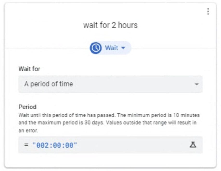

We are planning to release a new feature on the wait step where you can simply wait a period of time.
The new Wait step type allows the process to pause execution and before resuming:
  • [Wait for a condition] to evaluate to TRUE or a timeout period to be reached
    And here you can add steps in case the timeout period has be reached
  • [Wait for a period of time] (min allowed is 10 mins and max allowed is 30 days)
Note: Process execution will not resume at the exact time that time period is met. There may be a delay of up to 10 minutes. Therefore, the Wait step does not support use cases where accurate timing is required.

Hi Steven,
You user account has been added to the rollout for the new feature now.
As for lowering the minimum period, the Wait Step is targeting human-in-the-loop interactions for long running processes, so 10 minutes would be a reasonable minimum interval and we will stick with this in the initial release of the feature.

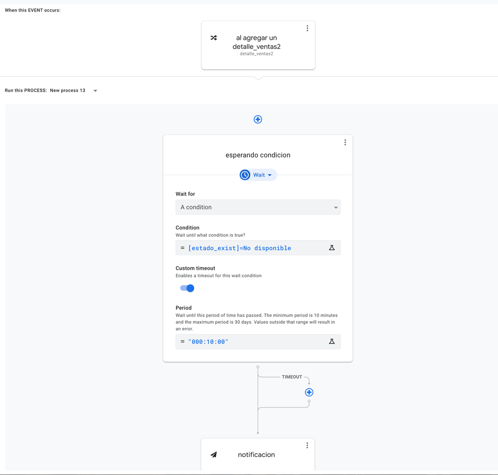

Thanks for adding @Steven_Aung , I would like to corroborate the operation of the wait condition action, if when the bot is executed the condition is met, the bot continues the flow? or after 10 minutes it resumes again ?. It happens to me that when the bot is executed, the condition is already being met and the bot continues, a behavior that I think is great. But if I wanted to know if after time it runs again?
Hi @FREDY_ORTEGON the short answer is No, it won’t run again
There could be 3 scenarios if you configure a wait step to have both a condition and a period (say 10 minutes in the screenshot above):
  • when you first enter the wait step, if the condition is already met, it will continue the flow without waiting and won’t run again
When you first enter the wait step, if the condition is NOT met, the process will go to “sleep” until –
  • within 10 minutes, another UPDATE happens to the same row that triggers the bot initially, and that updated row now satisfies the condition, the process will resume the flow
  • after 10 minutes, the process will resume the flow
Hope this explains.

Hi @Zhifeng_Lin
On the screenshot I see elsewhere, there is “timeout” step immediately after the Wait for a period of time step. Why and when technically this timeout will happen? Could you elabrate the case where timeout would happen?
Thank you.
Hi Koichi,
The new wait step is to have two different modes of operation –
  1. simply [Wait for a period] of time to delay the process, that is the use case discussed in this post.
  2. [Wait for a condition] to evaluate to TRUE or a custom timeout period to be reached
    And here you can add steps in case the timeout period has been reached
With the use case shown in the screenshot above, the wait step is to
"Wait for approval input for 10 minutes; if there is no decision after 10 minutes, send an email and auto reject the purchase"
Assuming we have a simple “purchase approval” table with the following columns
  • | PurchaseId | product | cost | approved |
Initially, a row [“ABC”, “vegetables”, “$100”, “”] (approved column being empty) triggers the bot and takes the process into “sleep”
  1. if within 10 minutes, an table update happens to the same row and set the [approved] column to “Yes”, the process will resume and return “Yes”
  2. After 10 minutes and there isn’t any table update to the same row to set the [approved] column yet, the process will be considered as “Time out”, so it will wake up entering the “Time out” branch and first send an email, then auto reject (a data action that sets [approved] to “No”), then finally return “No”
Hope the above example clarifies.

Hi Koichi, to further clarify:
  1. With “Wait for a period of time” selected, you are supposed to specify a period (between 10 minutes and 30 days), and the process will always wake up and resume the remaining flow after the specified period of time. And leaving it blank will default to 30 days. We should probably throw an error on “Save” to make sure a valid period is entered.
  2. With “Wait for a condition”, there is now a “Custom timeout” checkbox
    a. if “Custom timeout” is not selected (equivalent to having “period” blank), by default, after 30 days, the process is considered “timeout” and “die” without doing the rest of the process (this is the “old” wait step behavior).
    b. if “Custom timeout” is selected, you are supposed to provide a period again. Leaving it blank will default to 30 days. (We should probably throw an error if period is empty). And the process will not “die” but always resume after the specified period of time.
    • if the “timeout branch” is occupied with more steps, those steps will be executed first and then the remaining steps in the “main” branch. But you do have the option of “killing” the process without executing the remaining steps in the “main” branch by putting a return-step at the end of the “timeout branch” (that is what a return-step will do, which is to terminate & finish the process).
    • if the “timeout branch” does not have any steps, the process will resume and start executing the remaining steps in the “main” branch.
