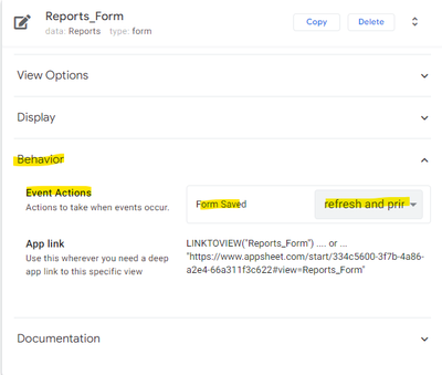

"when the user borrows the tool?" ==> this involves a form, I presume.
You may want to combine:
Event action "form saved", such as below
and use an action that is of type: "Data:execute an action on a set of rows", like the example below.
