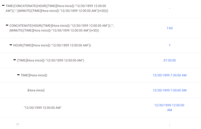

There is a problem when the time ends at :30 minutes,
for example "07:30:00" + "30"
results in "7:60" and not "8:00:00"
