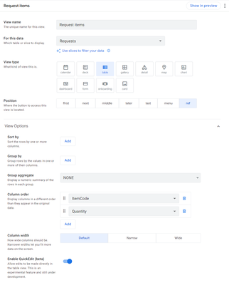

Thank you. What is the type of the view "Request Items". Is it a simple table view?
Could you mention what is the child table name? Is it "Items"? If so, do you have a sytem generated inline view called say "Items_Inline"? Also could you mention the name and key column of the parent table?

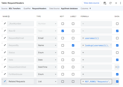

This is the ParenrtHeaders table
This is the children table

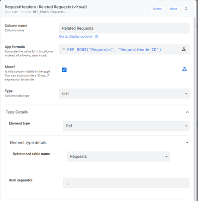

This is the Related Request Column in the RequestHeaders table

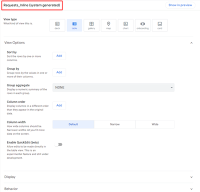

This is the system generated table view for Requests_inline

Thank you. Could you try an action expression of
LINKTOFILTEREDVIEW("Requests_Inline", [RequestHeaderID]=[_THISROW].[Row ID])
instead of your earlier shared expression

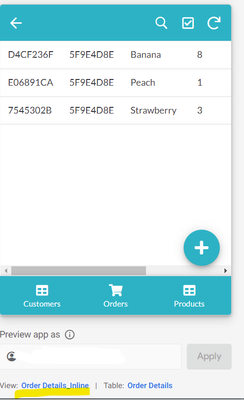

The navigation to "Requests_Inline" should open a table summary view, not sure why a details view of the parent  is showing up in your shared screenshot. Does the action not take it to an inline table view, something like below?
Could you share the latest expression you are using and also screenshot along with the view name as I have shown? The view name shows at the bottom in the editor.

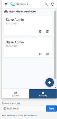

So now when I click on the card, the Request Items action is triggered and the Request_Inline table opens.
Clicking on the add icon takes you to the Requests_form
Adding new items on this forms attaches the children to the form as expected.
