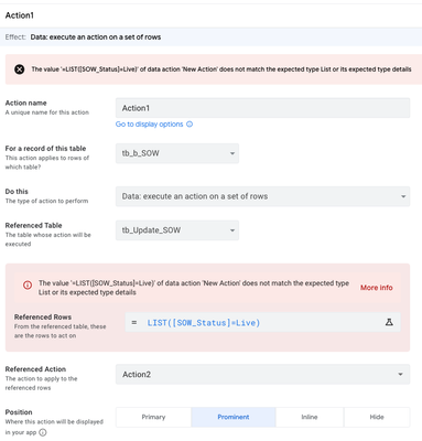

Hi @WillowMobileSys , I have tired to set up the actions - however I seem to be hitting an issue.
This is how I have setup the actions, I can see that there is an isssue with my selction of rows in "Referenced Rows" but I am not sure how to resolve tis, any ideas?
Action1
Action2
Hi there,
The Referenced Rows portion of Action 1, is asking you to provide a list of Refs to the Referenced Table aka a list of ids from your tbl_SOW that link to tbl_Update_SOW.
Try the below as your formula
SELECT(tbl_SOW[Row ID],([SOW_Status]="Live"))
The above formula is returning a list of tbl_SOW[ROW ID]'s, and as these are already a ref to tbl_Update_SOW, it will return the rows in the tbl_Update_SOW table that need to be updated.
Let us know how you go
cheers,
Thanks @paulbroomfield!  I shall take a look.
Hi @paulbroomfield - thanks for your help.  The select query has resolved the error - however I am having trouble understanding where to trigger this from.
It seems in the setup I currently have a user needs to go into the update table to trigger the events at a record level, which seems unintuitive for what I am trying to achieve.  In the current set up I would ideally like someone to go into the tb_b_SOW view and trigger from that location, but I can't figure out which action to trigger first or how to get this to run for all records.
Ideally what I would like is:
  1. a stand-alone button somewhere in my app that an admin clicks
  2. when they click this button an input field pops up saying something like "you would like to create a new set of records for reporting, please specify the reporting month"  ...to which they would add the reporting month as 2025-01 etc
  3. The actions would then kick off, first checking what Projects have a status of live, then adding those records into the child update table.
I (ideally) don't want the admin to have to click each individual row in the projects table (tb_b_SOW) in order to generate the update records (in tb_Update_SOW).
Am I going beyond what AppSheets can do here do you think?
Massive thank you to you and @WillowMobileSys for your help so far!
For context here are the two actions again (note you may have already notice that I have changed the table name slightly from my original post to tbl_SOW to tb_b_SOW....not super important but thought I would mention!):
No, you are not.
The actions look good are far as I can tell.  You would Action 1 as your button.  Unfortunately, AppSheet identified this action as a "row level" action and will not allow it to be shown as a Primary presented button - one that floats in the view.  Instead the button must be shown on the Detail View (and can be primary there) OR as an Inline button displayed on every table row.  Neither are ideal solutions and is part of the "less user friendly"  portion I alluded to in my prior post.
I hope this helps!

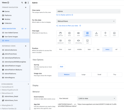

I've done something like this before using a table and some custom actions.
1. You need a table called MenuViews
2. You need an action that is called when a MenuView row is clicked
3. Add a new item to your app menu
4. Set your new view in behaviour when a row is clicked
5. A table called ReportDates
6. You need a form view
Setup:
1. MenuViews table, with the following columns
idview namenameimage
Example data:
1AdminRegionsRegionsAdminViews_Images/1.image.082728.png
2AdminFranchisesFranchisesAdminViews_Images/2.image.082752.png
3AdminPlatform MediumsPlatform MediumsAdminViews_Images/3.image.082803.png
4AdminPlatform ImagesPlatform ImagesAdminViews_Images/4.image.082813.png
5AdminCollectionsCollectionsMenusViews_Images/5.image.090313.png
6AdminGamePlatformsGames by Platform
7AdminGamesWithMissingDataGames with missing data
8AdminPlatformsPlatforms
Note: The image col is there incase you want to display an image as the "button".
Add the new table as a datasource
2. In the views section, goto your MenuViews section and add a new action called "Link to view" It should look like this:
What this does is, when a row in MenuViews is clicked this will open (LINKTOVIEW) a view with the value from the rows [view name] column
3. Add a new item to your app menu, see below screenshot - note the behaviour setting - this should be the name of your action from Step 2
4. Confirm you have set the behaviour as per Step 3
5. report dates table, this will be 1 row and the year_month col will be an Enum of YYYY-MM which will be displayed as a dropdown on your form
e.g.
idyear_month
1
Note: not need to populate the year_month col, we'll do that in AppSheet
Add the new table as a data source, edit the year_month col to look a bit like this (there is probably a better way of doing this, like with a dynamic list, but lets see how this does)
6. Your form, in the reference section of your App Menu, create a new view, set its type to form, name it the same as your view name from your MenuView table, set it's "For this data" to be "ReportDates".
In Behavior for this form, set the "Form Saved" to be your action that adds rows to another table. You'll probably need to update your SELECT to also include the ReportDates.year-month field
Let us know how you go, this is all very off the top of my head 🙂
Had another thought about this and my first idea is way too complicated:)
you can skip step 1 & 2 about creating the menu table, and instead add a new menu item that links straight to the form
also there’s a part in thr from that I forgot to add, it asks for a row that this form will reference, that should be the [id] = 1
cheers
