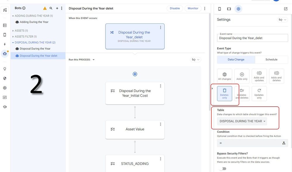

For delete you want to use bot
These steps how to create bot with action.
thanks a lot for your guideline. Actually I already found the way to update the copied row when changing data from original table, and also set up Action & Automation same same as your doing. Thanks again.
