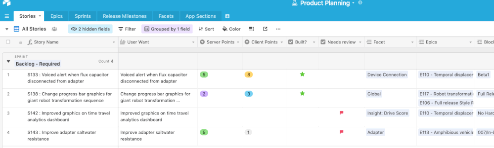

It’s populated, but with the field type “link to another record” this is what it looks like from the airtable side.

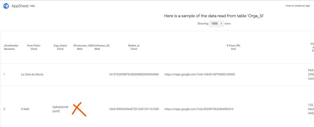

  1. I have a table called “adverts” in airtable which has a reference column “agent” that links it to the “agents” table. I’ve set this table up in appsheet as adverts. And I’ve set this “agent” column type to “ref” in appsheet.
  2. The “agents” table in airtable has columns “agent-name” and “agency-name”. These columns do appear in table structure of the adverts table in appsheet, but the values appear all BLANK.
Can you advise what needs to be done to retrieve values in appsheet for these columns from the linked table in airtable?
