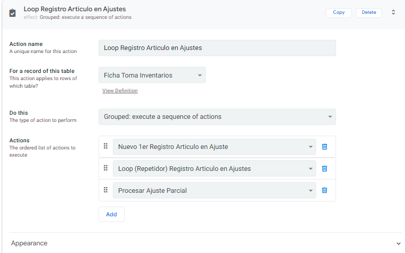

I’ll show you how I built it to see if you can help me:
This first is the one that makes the loop repeater:
This is the sequence of actions that the loop will do:
And the record that makes the loop:
In addition, there is also a bot that validates if one of the records is greater or less than zero to record part of the information in a third table.

@Inventarios_FOODis I see you have some potentially very expensive formulas in your action that adds new rows, we should start from there, could you share some more information about those and your column structure so we can see if we can improve those expressions?
EDIT: I mean the expressions belonging to “Cantidad Real” and “Cantidad Ajuste”
Once we squeeze a bit of performance out of those, we can evaluate if we need to impose a limit on how many rows your loop grabs at once, we can do that using a slice and an auxiliary column, but more on that later.
Also, what does your third action in your sequence do?
