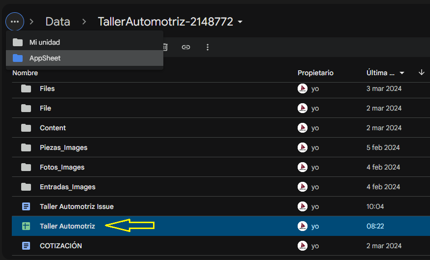

This is the path of the app in Google Drive:
My Drive --> AppSheet --> Data --> TallerAutomotriz-2148772
Here is the GSheet.  The yellow arrow is pointing to the file (Taller Automotriz)
This is the path of the folder "Presupuestos" where the PDF files are saved:
My Drive --> AppSheet --> Data --> TallerAutomotriz-2148772 --> Files --> Presupuestos

When using a file or what ever image column type, the path needs to start from the folder where the Google sheet is. In this case it's in Root > appsheet > data > TallerAutomotriz-2148772.
Now the app tries to read the file from Root > appsheet > data > TallerAutomotriz-2148772 > appsheet > data > TallerAutomotriz-2148772 > Files > Presupuestos and of course it can't find it as it doesn't exist.
To fix this, you need to modify the app formula using something like CONCATENATE("/Files/Presupuestos/Presupuesto ",[Presupuesto]," v",[Version],".pdf")

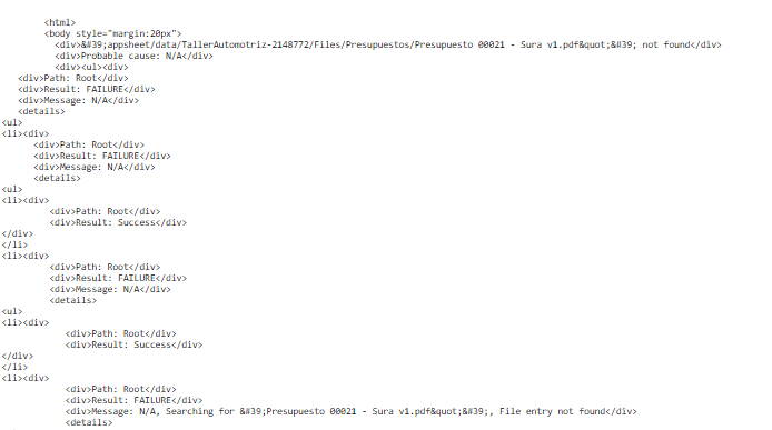

@AleksiAlkio, I found this folder structure within the app folder.
This is the path I had in the formula of the PDF column:
CONCATENATE("appsheet/data/TallerAutomotriz-2148772 Files/Presupuestos/Presupuesto ",[Presupuesto]," v",[Version],".pdf")
The PDF files have a size of 0 bytes and can not be opened.
Maybe that's the reason of this error.
This error is the subject of this post:
An error was encountered while processing the file. Some features might not work.
Does this give you any clues?
That's probably true. If the size is zero, it won't open it.
