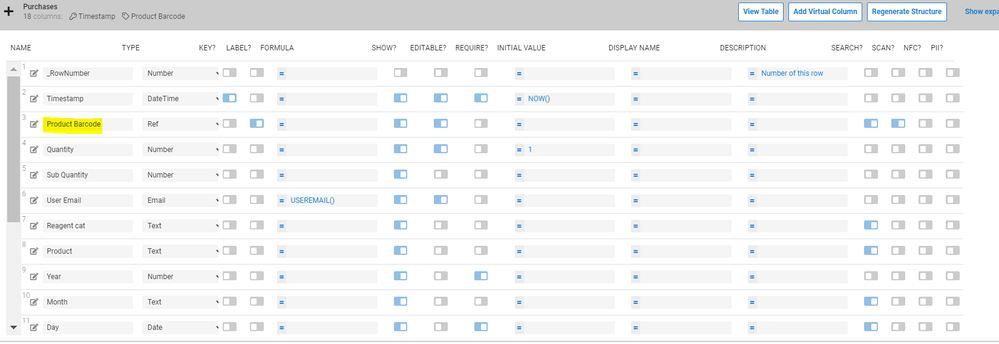

No I donโ€™t have any such expression. Please find the attachment of the column structure for my first and second scan:
In your Purchases table, the Product Barcode is a REF column, possibly referencing your Products table and in that table Product Barcode is the key column. So when you scan a barcode from Purchases table, itโ€™s looking up that scanned code if itโ€™s existing as a key column value in Products table, therefore itโ€™s returning that error message.
Yes the barcode in the purchases tables refers to the barcode in products table.
Lets say for example I scanned a barcode first in products, the barcode details got saved in the sheet. Then when I scan the barcode on purchases table, it looks for the same barcode in the products table and I get an option to add x quantity of that product.
But whatโ€™s happening in my case is, when I use an android device to scan on the purchases table, I get the error I attached above.
However if I use the same barcode using an Apple phone, the data is updated and I dont get any error.
