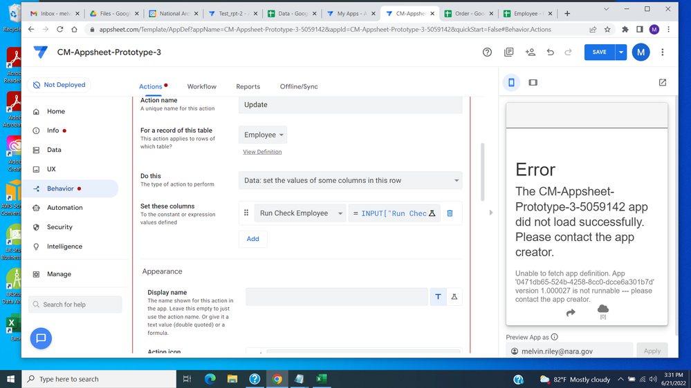

Hi Steve, I am trying to use the INPUT() function however,  upon usage of it, I get an error:
There may be other issues, but one detail you need to fix is to replace the brackets with parentheses. All AppSheet functions, including INPUT, use parentheses. Brackets designate columns.
Of course you're right. Thanks alot that solved the problem.
