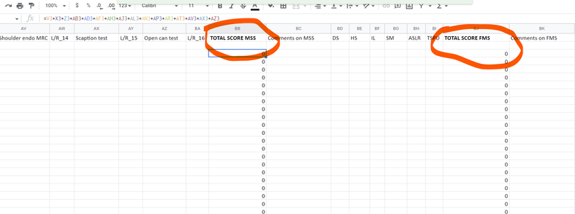

So everytime I put in data in appsheet and I sync, it also syncs with my spreadsheet, the only thing is that the given input will not show in google spreadsheet. I got a feeling it has to do with some new colums I put in within the spreadsheet. These colums are 4 columns with functions within spreadsheet (not within appsheet). Everytime I fill in things in appsheet, the functions dissapear in the 2th row in spreadsheet. So the whole row 2th row is blank except for 2 columns (2 with functions) the other 2 dissapeared.
As you can see everything is blank and the two functions on the 2th row dissapeared.

So I think the most immeditate issue is that you're using a combination of Appsheet and spreadsheet formulas.  The later is why you're getting the read only warning.  If appsheet sees that spreadsheet cell has a spreadsheet formula then it sets that as read only in the appsheet editor.  So in the example above where you have this in column U:
P2+Q2+R2+S2+T2
you need to delete that and instead go into the settings of the [TOTAL SCORE VRAGENLIJST] column and set the App Formula to be
[Vraag1]+[Vraag2]+[Vraag3]+[Vraag4]+[Vraag5]
 Do that with all the spreadsheet formulas and see if that fixes some or all of the issues
