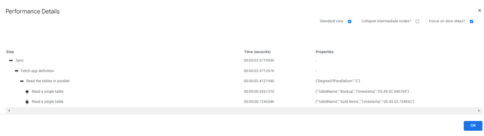

I'm having a bit of a nightmare with my app, in the last few days it has started running super slow, taking approx 80 seconds to sync. I have not made any major changes at all to either the app or the linked spreadsheet, other than very minor formula changes.
I have tried restoring the app to a date prior to when the slow syncing began, but it hasn't helped, the app is still taking 80 secs to sync.
I'll add some screenshots showing the performance analyzer, if anyone is able to read this and make sense of where the issue is, that would be a huge help as I'm at a loss.

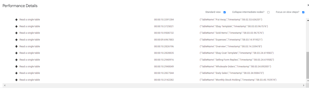

For some reason when Im running a sync, the app is now reading every single table, instead of just a couple which it was doing before. It is also taking substantially longer per table.

Why you might have seen a sudden jump in Sync time I cannot explain - unless one of your changes wasn't as small as you might think.
Based on the views, there is not any single culprit.  The timings seem fairly spread out across the tables.
However, you will also want to drill into each of those "Read a single table" items.  They will provide you a breakdown of how much time is actually spent on retrieving the data versus calculating Virtual Columns.
Typically, in apps that suffer slow sync times. it is the Virtual Column calculations that are impacting the app the most.  The biggest issue with Virtual Columns being that if they are performing calculations that require SELECT's over large tables, as those tables grow in size, the Virtual Columns get slower.  Even worse are SELECT's within SELECT's  as performance issues can become compounded.

Had same thing there is another report on ‘speed’ issues today. Saw super slow table read speed 10+ seconds up from milliseconds total synch went from below 6 sex to 220+ with most failing saying network.
As you no recent changes.  Made a support case and now mysteriously my time is back at 6 seconds.
Simple one row tables we’re taking 10+ seconds to read
in the last hour seems to have corrected itself awaiting word from my support ticket but this is not the first time appsheet has released bad updates and it takes users complaining let’s see if they don’t sweep this under the rug
Thanks for the reply, much like you have said I think this may be an appsheet issue as opposed to my app. I have just tried syncing my app this morning and its miraculously back to a 3 second sync. Its still a bit slower than it was a week ago, but I can live with 3 seconds, 90 seconds was a bit unbearable.
Interestingly, on the performance log analyzer, the app is back to only reading 2 tables when it syncs, whereas before it was reading all of them
Hi, Thanks for the reply. Interestingly the last sync I did last night while trying to figure this out was still taking 80+secs, I have woken up this morning and the sync is back down to approx 3 seconds! But I will answer your points anyway. My guess is that my app/appsheet got itself in a twist and its rectified over night.
