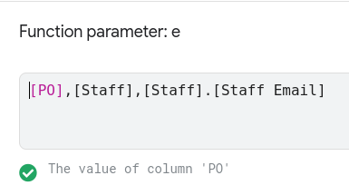

Appsheet interface is waiting for an expression to pass it in:

I tried to pass it in as a JSON and used the following in the Function parameter e:
  "email": [Staff].[Staff email],
  "staffName": [Staff],
  "poID": [PO]
And the app script exection log gave me this error
TypeError: Cannot read properties of undefined (reading 'contents') at doPost(Code:3:36)
what should I do?

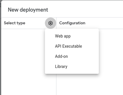

@scott192 Okay.  I'm creating that new project and I want no slip ups.  What should I deploy it as?
You don't deploy it!

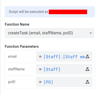

Just save your script and add it in your bot  as an Appscript Task
@scott192 you were definitely right about what I would see in appsheet😄
And I filled it out accordingly
But I get the error:
Which I don't understand cause my function only calls for 3 arguments.  Why is it expecting 1 to 2?
