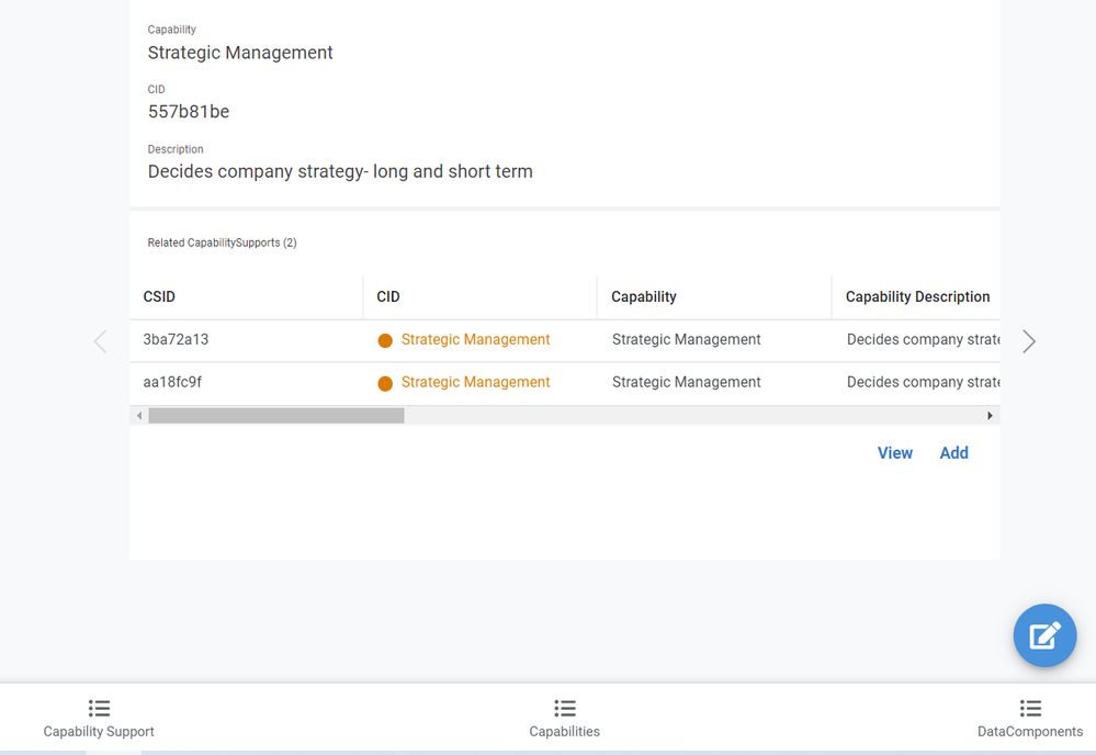

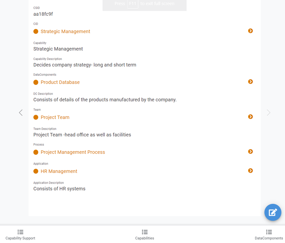

So the detail view of a CapabilitiesSupport record could look like below. The record below has 4 support attribute references for capability โ€œStrategic managementโ€
This is another record from the bridge table CapabilitiesSupport for the capability of Strategic management.
This is detail view of Capabilities table where those two Capabilities Support records appear as related records.

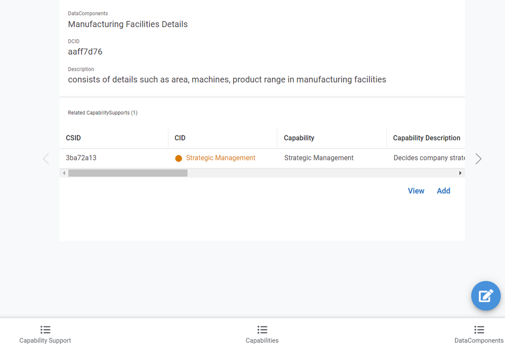

The below is detail view of Data Componentes detail view where the related record from
CapabilitiesSupport table shows up.

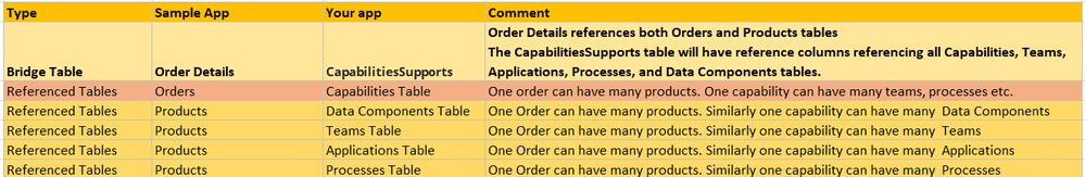

As I have mentioned, the central concept is a bridge table that connects Capabilities and the 4 attributes. The bridge table concept is also demonstrated in the sample app referred below.
I will try to compare the tables in the sample app with the tables in your requirement so that you get perspective. Hope this helps.
