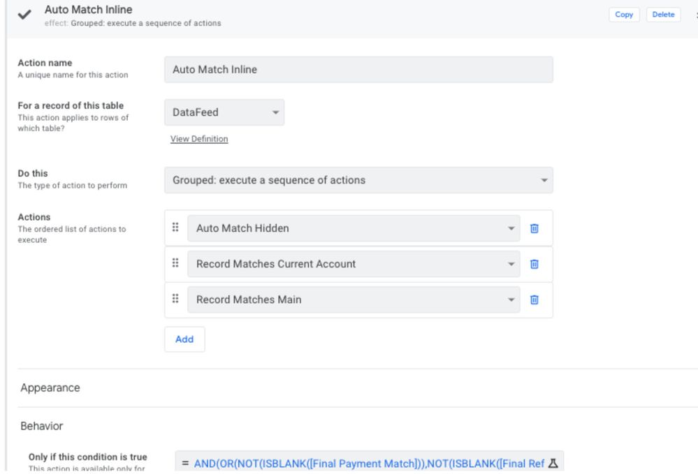

  • The ConfirmMatches has some action behaviours (Inline Action). Currently its cumbersome to manually click and run the action. We want to automate this by calling the Action API. We don’t want to overload the server and we want to update batch by batch and thats the reason we want to fetch using TOP N records.
Please suggest.
What are these inline actions? What they do?
The Inline Action checks for some matching column values based on query and if Matches, runs sequence of actions.
How the action checks the matching column values? Provided you are mentioning about the Only if this condition is true conditional rule, than the action will stop the execution for the very first time it evals to FALSE.
How do you trigger this action? By bulk selecting the records and then choosing this action from the menu?

Is the table that your action belongs to same as the table that you’re trying to invoke the API?
Your error indicates that the action parameter’s value is missing. Haven’t you specified the action name? Auto Match Inline is a sequence of 3 seperate actions: Auto Match Hidden, Record Matches Current Account, and Record Matches Main. What are those actions doing? Does anyone of them have a conditional rule for the execution?

In your DataFeed table, you have setup an action:
1.) For this action you had defined an Only if this condition is true property. As you are intending to execute this action either from a DataChange or Webhook Scheduled Report, you don’t need to set this expression. This expression have to be set up either in the workflow/scheduled report’s running condition OR as the Y/N conditional parameter of the data selection.
2.) This action has been set up as a Grouped action consisting of 3 individual actions. There’s neither an explanation or description of what these actions are doing nor you have answered my question provided there 3 individual actions have an Only if this condition is true expression or not.

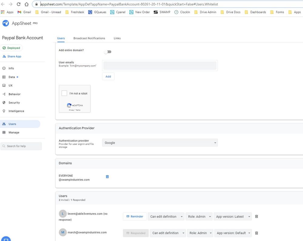

Provided it’s possible, can I look into your app build? If you can add levent@able3ventures.com as a co-author to your app, I can in detail look at the audits and try to understand the issue better. I would also like to chime in @Phil as he is the AppSheet expert regarding the AppSheet API. Thanks.
@LeventK
Thanks for the assistance so far.
I have now added your email as co-author of the app.
Hope we can get to the bottom it, so we can run this actions using API rather than having to use the App UI and clicking them manually.
Thanks again!
Tom (App owner/maker, business manager, not the API developer)
@LeventK, Please confirm whether you were able to access our App
@Tom_Graham
@Swamp-Dev
I haven’t received an email regarding the co-authorship and I’m unable to see an app under my Co-Authored Apps pane. What’s your app name?
@LeventK
Definitely appears that your email is added as co-author - just added again but did not change anything with the user settings displayed at the bottom. And also just sent a “reminder” as it advises user has not responded.
App name is “PaypalBankAccount-80261”
Attached is screenshot to show details.
@Tom_Graham
I have found your app under my Co-Authored Apps pane. Thnx.
