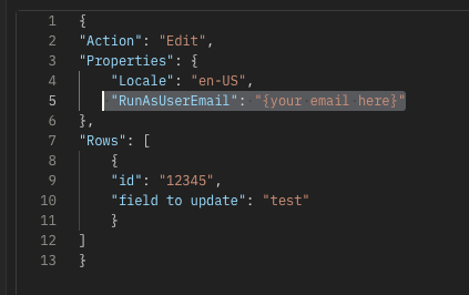

FYI seems like I found a good solution here:
1. I had to explicitly allow a given email to view all records in the security filter for the table I wanted to edit via API.
2. I then used the RunAsUserEmail property in my API call, referencing the same email from step 1.โ€ƒ
Context: I was getting the 404 error saying "Row having key '<key value>' not found" when I tried to update rows that I knew were in my table. I knew security filters were my problem but couldn't figure out a way around it. The advice on the API troubleshooting page wasn't very helpful and messing with the system provided User Settings table was going to require really difficult changes to my security filters and views. The solution appears to be, the email that the API action is executed as must explicitly have access to the rows you want to edit, in the table security filter.
