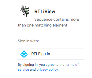

AppSheet Authentication Error
Starting to see this error this morning, users are not able to login...

Getting the same issue. Native sign in with microsoft is giving exactly the same error

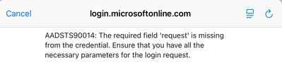

Different error we have come across. It looks like the way AppSheet is handling authentication has changed, either how it passes the parameters or how its checking them.

We also see the same error since today. We use Microsoft for authentication. All other applications with Microsoft work fine.
Error Message: Sequence contains more than one matching element

we having the same issues also. Error Message: Sequence contains more than one matching element.
and after pressing the Azure AD button (or microsoft button) for 11 times, it totally crashes, especially in InPrivate mode.
We have a ticket in with AppSheet as well and are still seeing the issue with several users - not all. @AleksiAlkio can you help us escalate? Clients dealing with operational issues as a result since yesterday morning. Case ID is 9-7086000038317  Here is the troubleshooting completed from the client's side on the device thus far:
Iโ€™ve done two logins on the same device.  One login works (email1) and the other does not (email2)
Here is the process.
Clear AppSheet cache and data
Clear Chrome cache and data
Log in with respective email address
I can repeat this process over and over.  email1 shows both the LIV_DS_Manager and Route app in the App Gallery.
I repeat the process.   email2 receives the error message  โ€œSequence contains more than one matching elementโ€
When I repeat the clear cache steps and then log in again, email2 ALWAYS receives the error message and email1 NEVER has the error message.
This is on the same device.   Using a different device the result is exactly the same.  If I login with email2 on a different device I receive the same error.   If I clear the cache and data as I described on this same device that just failed, and login with email1, both DS and RS app display in app gallery.
This is not device specific, it is something to do with the user login.   Uninstalling and reinstalling the AppSheet app does not change the behavior.

Just confirmed we're still unable to login with some users and getting the same "new" error as the others:
Same for us, just for a single account right now.
@AleksiAlkio we have a different error now during login. It is the same as one month ago: https://www.googlecloudcommunity.com/gc/AppSheet-Q-A/Appsheet-ID-on-existing-default-UserAuth-does-n...
Error: AppSheet id on existing default UserAuth does not match.
We are seeing this same error, but only for one account so far.
