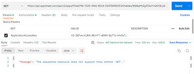

I tried Invoking the API in postman, for which I got the following error :
I used this API : https://api.appsheet.com/api/v2/apps/{App ID}/tables/{Table Name in Unicode characters}/Action?ApplicationAccessKey={ApplicationAccessKey}
Correct!  Presently, you cannot "pull" data from an AppSheet app.  An external service can only send "Adds and Updates into AppSheet.  OR...AppSheet can "push" data to PowerBI through their, PowerBI's, API if it is a REST API.  But you would need somewhere for that data to go to.

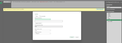

hola;
intente usar tu consulta pesonalizada pero me dio el siguiente error, como se podria resolver?
Expression.Error: No se reconoce el nombre 'application'. Asegúrese de que se ha escrito correctamente.
= Json.Document(Web.Contents(url,[Headers = [#"Content-Type"=application/json], Content = Text.ToBinary(body) ] ))
Te faltan comillas.
Intenta copiar el código tal como lo compartí
Incluyo las comillas dobles?
Así es
