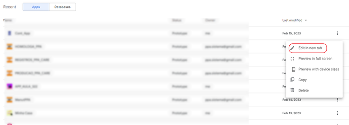

Guys, I found a way to make it work for now.
Instead of opening your app from the home screen, click on the "Edit in new tab" button from the side menu.
This way the toolbox initializes.

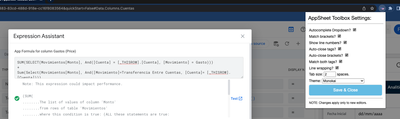

I use Appsheet Toolbox in 2 different Chrome profiles.  It's working in one but not in the other. Also, in the profile where Appsheet is not working, I can't use the "Insert" option in the Expression Assistant in order to insert expressions.
I have deleted cookies, deleted and reinstall the extension, deleted the profile and created it again, but it's still not working.
When the extension is not installed, the "Insert" option in the Expression Assistant is Ok. It seems Appsheet toolbox is affecting the Expression Assistant.

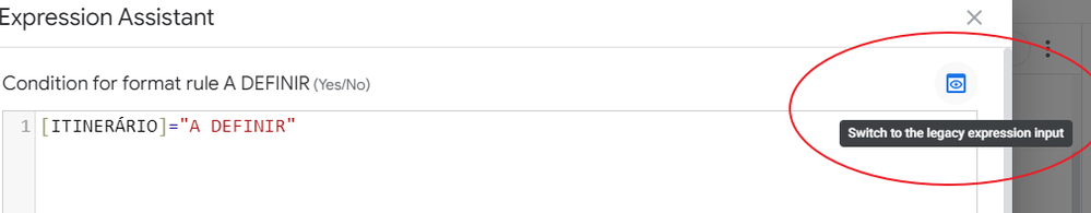

There's a new built-in expression editor that disables the third part Chrome extension. But it's possible to go back to the previous editor. See the image below:
