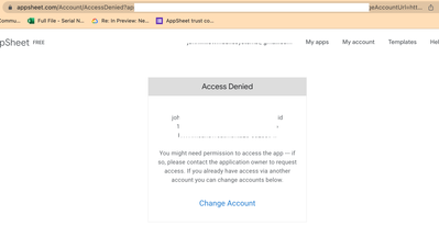

Injection attempt for user without access

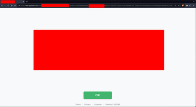

Current version:
Forcing 1.000288:
Forcing 1.000280:
Forcing 1.000275:

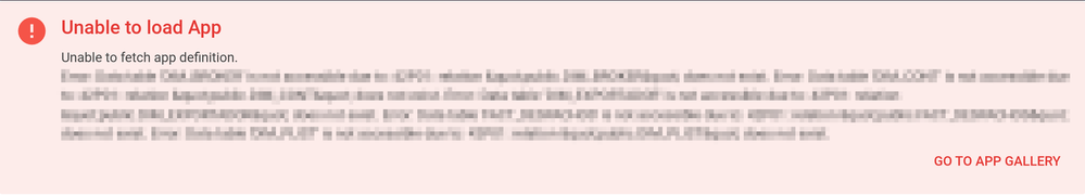

Going older than that triggers an error, similar to the first screenshot you shared.

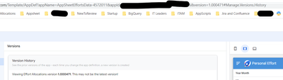

To put all this together and understand how all of these work together, just look at the Editor URL it uses all three of these.  See image below
