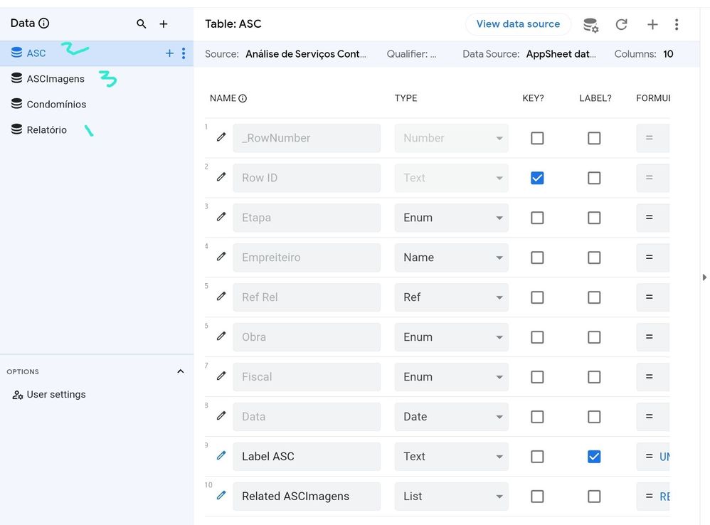

Below there is all the tables' types and names, if this help somehow.
Screenshot_20231027_092722_Chrome.jpgScreenshot_20231027_092802_Chrome.jpgScreenshot_20231027_092905_Chrome.jpg

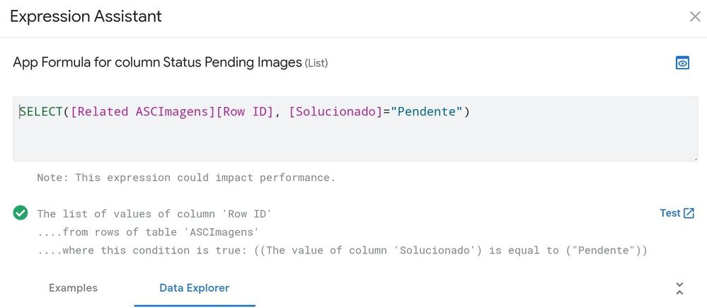

1)  Please add a virtual column called say [Status Pending Images] in the "ASC" table with an expression something like SELECT([Related ASCImagen][Row ID], [Solucionado]="Pendente")
The type of this column should be list type, with element type as ref and referenced table name as "ASCImagen"

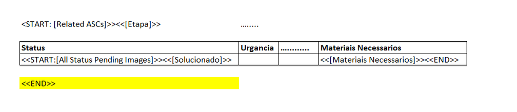

3) Then the start expression within the template table can be something like
I think you will also need a closing <<END>> statement for <<START: [Related ASCs]>><<[Etapa]>> something like below

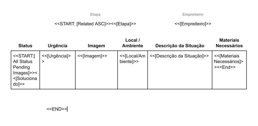

Sorry, but it didn't work. I followed as you described but still something is wrong. Could you please take a look again?
<<START: [All Status Pending Images]>><<Solucionado>>
And again here is the structure:
Screenshot_20231027_141301_Chrome.jpgScreenshot_20231027_141331_Chrome.jpgScreenshot_20231027_141407_Chrome.jpg

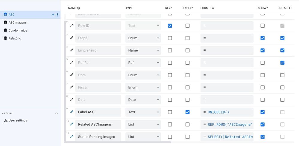

Inside ASC table I created a virtual column:
And inside Relatรณrio table I created the other virtual column you mentioned:

Is the statement <<START: [Related ASCs] >> inside a hidden table cell by any chance?
There could be something else in template that could be causing an issue. The templates need specific formats , especially the way <<START >> and <<END>> expressions are coded. A minor variation can cause an issue.
