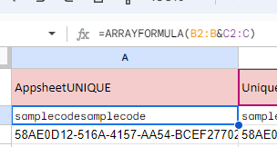

Hi, i have complete data from spreadsheet with uniqueid and all of the data is arrayformula except for 1 column which needs to be filled by user in the appsheet
the problem is, the appsheet seems to not showing the row where the column needed to fill by user is blank, and only showing the filled one, is there anything i miss in the config ?

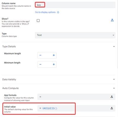

Probably because you have a spreadsheet expression in the Autocompute area of the column [UniqueId].
A good practice is to have this expression:
UNIQUEID()
in the Initial value expression of the column:
and nothing else for the key-column.
For reference:
What is a key? - AppSheet Help
UNIQUEID() - AppSheet Help

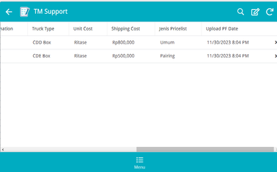

my view type is table, as you can see my appsheet view table only showing 2 item here
while on the spreadsheet it has a lot of data
and the appsheet only showing items where the column i need user to fill is already filled

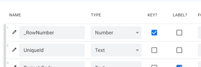

Can you check which column wears the KEY property ? From what I see, it could be the [Upload PF Date].
AppSheet will only displays rows with a key.
ok, i think that makes sense, i see my key is referred to _rownumber
so i changed it to my uniqueid
but as soon as i hit save, the appsheet change it back to row number
why does the appsheet did it ?
UNIQUEID()
For reference:

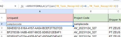

yes, my unique id is a formula in the spreadsheet which refer from another table, the id is used to get data from another table,
while this view type is edit only, no new row will be added from appsheet, i think it is quite difficult if using UNIQUEID() in the initial value, is there any method that i can approach ?
I would suggest jsut reomving the expression in the app editor, set the key property again on it, then saving. Don't change anything else ๐Ÿ™‚
nvm, i just tried to create a new column with arrayformula of combined item from other column
and voila, i don't know why but it works now
