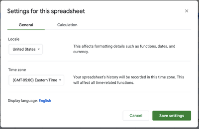

  • Some time zone set on the data source? For example, a Google sheet's time zone setting:dbaum_0-1654460790046.png
