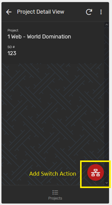

When in the detail view of Project, I need to be able to add a new switch record and associate it with the project. I have added an action that navigates to a view based on a slice of Switch to allow a new record to be added.

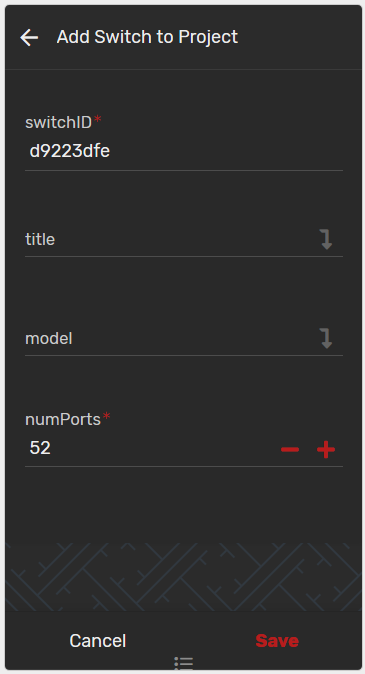

  2. User Presses “Add Switch” action button. This takes the user to the form used to enter new switch details, as though they had navigated to the Switches view and pressed the + button. (This is what my app currently does)
  3. User enters new switch details.
  4. User presses “Save” and is returned to the Project details page. At this point a new record is created in projectSwitches table, adding the ProjectID from the current project and the SwitchID from the new switch they just created.
