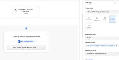

Steps 1-3 work fine, the last step [4] does not work.  * This may be because it needs to wait for the property to be deleted. I have tried this as a Group of actions as listed above. Also as a BOT see screenshot below.
Please note step [4] does work if you leave the action visible and click on it manually.
The Bot runs without error but the references in the test-scenarios to the now deleted property remains. This is likely to be something simple, hence the question.

Actions are performed within the context of a row. If you've deleted the row, there is no context for the remaining action, so the remaining action does not run. Deleting itself must be the very last action the row takes.
Many thanks @Steve for the explanation. The problem is how do I tell the actions in the list which property is being deleted?  For now I have created a 'logical-deleted' flag, which is the first action and sets this flag. While the record physically exists, the other actions have something to reference. The UI then filters-out the logically-deleted records so they are not displayed.
Not ideal, but I wasn't sure if there was a de-reference of some description that would work. This solution is using Actions alone, not a Bot.
This is a good approach.
  1. Flag the property as deleted (e.g., set [Deleted?] to TRUE)
  2. Remove loan-details (e.g., [Related Loan Details])
  3. Remove test results (e.g., [Related Test Results])
  4. Update the test-scenarios to remove the deleted-flagged property (e.g., SELECT([Related Properties][PropertID], [Deleted?])) from the test-scenarios.
  5. Delete the property
