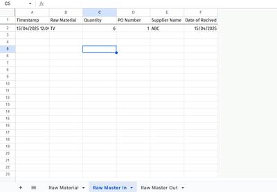

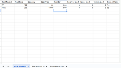

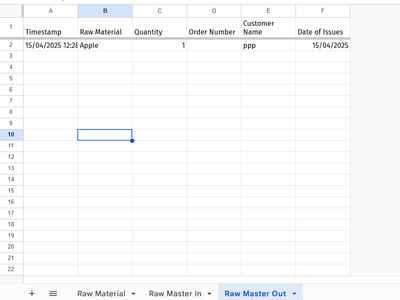

Auto update Inventory Master
I have created an app sheet to track inventory for entries coming in and out. There are three sheets in Google Sheets: Inventory Master, In, and Out. When I enter In inventory, the Inventory Master should automatically update the "Received" column with the new entry. However, in my case, it does not update automatically. Instead, I need to edit the Inventory Master form and click "Submit" to receive the entry details.
Example:
In the Inventory Master, the stock entry shows as 0. When I enter a value of 100, I expect the Inventory Master to automatically update from 0 to 100. However, I currently have to go into the Inventory Master form, click 'Edit', and then 'Save' for the new entry to appear.
1 10 326
Thanks for sharing the screenshots and context. You're on the right track, and this is a common AppSheet behaviorโ€”table values like โ€œReceived Stockโ€ in the Raw Material table wonโ€™t update automatically unless you use App formulas or actions to recalculate them.
Hereโ€™s how to fix it so that your "Received Stock" column in Raw Material updates automatically when a new record is added to Raw Master In.
Goal:
When a new "In" record is added for a material (e.g., Apple), it updates the "Received Stock" in the Raw Material master table.
Step-by-step Fix
1. Make "Received Stock" a Virtual Column (or use an App Formula)
In your Raw Material table, go to the [Received Stock] column and set the formula:
SUM(
  SELECT(
    Raw Master In[Quantity],
    [Raw Material] = [_THISROW].[Raw Material]
What this does:
It looks at the Raw Master In table
Filters for rows that match the current raw material
Sums the quantity values
> If you make this a Virtual Column, it will always stay updated. If you use a regular column with an App Formula, it updates only when the record is touchedโ€”but virtual is usually better for this kind of real-time summary.
2. Do the same for "Issues Stock" (optional)
In the Raw Material table, for the Issues Stock column, set:
SUM(
  SELECT(
    Raw Master Out[Quantity],
3. Calculate Current Stock Automatically (optional)
Create a Virtual Column (or use an App Formula) for [Current Stock] in Raw Material:
[Received Stock] - [Issues Stock]
No More Manual Edits Needed
With this setup, your Inventory Master table (Raw Material) will update automatically whenever new "in" or "out" records are addedโ€”no manual edits or saving
Updates between tables do not occur automatically.  You must create actions or Bots to perform these updates.  Maybe you have done that?
A common problem when building these updates, is that the actions lose access to the original row in order to retrieve the entered value that needs to be sued to make the update.  AppSheet introduced the INPUT() function to helps solve this problem.  It allows you to pass values between actions.

Hey,
you should have one Master and one Detail (Child) Table.
The SUM() of the Child-Records is the Stock-Amount in Master (IN +1, OUT -1 = 0 in Stock)
Cheers
