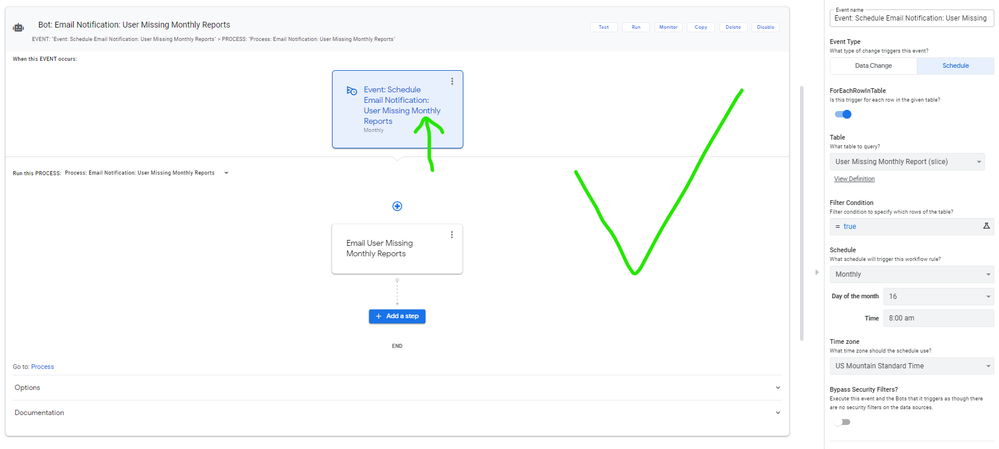

The first bot checks out correctly with the event reflecting correctly as Monthly:
The second bot however appears to still show the correct event and Table slice, however the schedule is the same as the Monthly Bot instead of what the event reflects for the Weekly:

The issue is that the event was setup for a weekly schedule and the bot correctly shows it is tied to the weekly event. However, when in the BOT configuration screen, it shows the correct (weekly) event but the schedule is set to a monthly schedule. So the bot is showing the right event (by name anyways) but it is not showing the schedule that is tied to that event.

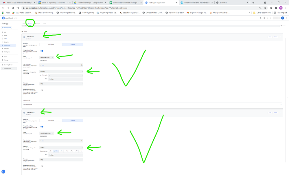

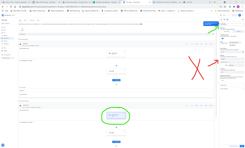

Just thought I would follow up with some screen shots hopefully for some additional clarification.

  21. Although from here one can continue setting up the step and task, go to the first bot, click on the event linked to the first bot and note that at this time even though the first bot event was set to โ€˜Monthlyโ€™ it has now been changed to โ€˜Weeklyโ€™ instead matching the event schedule from the second bot even though there are two different events each with their own schedule.
  22. Within the bot itself whenever the โ€˜Eventโ€™ schedule is changed it also changes the event schedule in the other bot. The events themselves under the event tab however stay the way they were initially set up.
For anyone following this, I have arrived to a point where it seems this is a visual issue specifically as it pertains to the event under the bot setting. I have done further extensive testing on an application that was solely created to test this behavior.
What I have found is that when editing the event schedule under the BOT configuration, this schedule will reflect the same under either of the two bots even though the event configuration under the โ€˜EVENTSโ€™ section reflect two different events with different schedules.
I have tested that the events linked to the bots execute correctly by moving the test application to deployment and continually resetting the event schedules to give me almost immediate results in the actual execution of the bots. I found that although the bot event schedule reflect the same schedule, the bots do get executed based on the โ€˜realโ€™ schedule that is reflected within the event under the โ€˜Eventsโ€™ section.
Based on this I have concluded that there must be a visual issue under bot-event-schedule specifically, however I have been unable to remedy this. I have attempted to see differences across different computers as well as browsers, however the โ€˜visual bugโ€™ remains. So still not quiet sure what the issue is or how to resolve it, either way it is somewhat bothersome as this should not be the intended behavior within the editor.

@Dan_Bahir one additional detail to note.
Earlier I changed the schedule under the Bot for the weekly event schedule for 2pm my local time. I did this in my actual production application because the event never executed last week so I still needed the event to happen anyways. The bot did NOT execute based on the assigned event schedule.
I went back to the event under the EVENT section instead and adjusted the schedule to run at 2:20pm my local time. In this case the scheduled BOT did execute. So the takeaway appears to be that when editing a schedule under EVENT section it properly registers the schedule, when editing the event schedule under the BOT section the schedule does not correctly persist.
