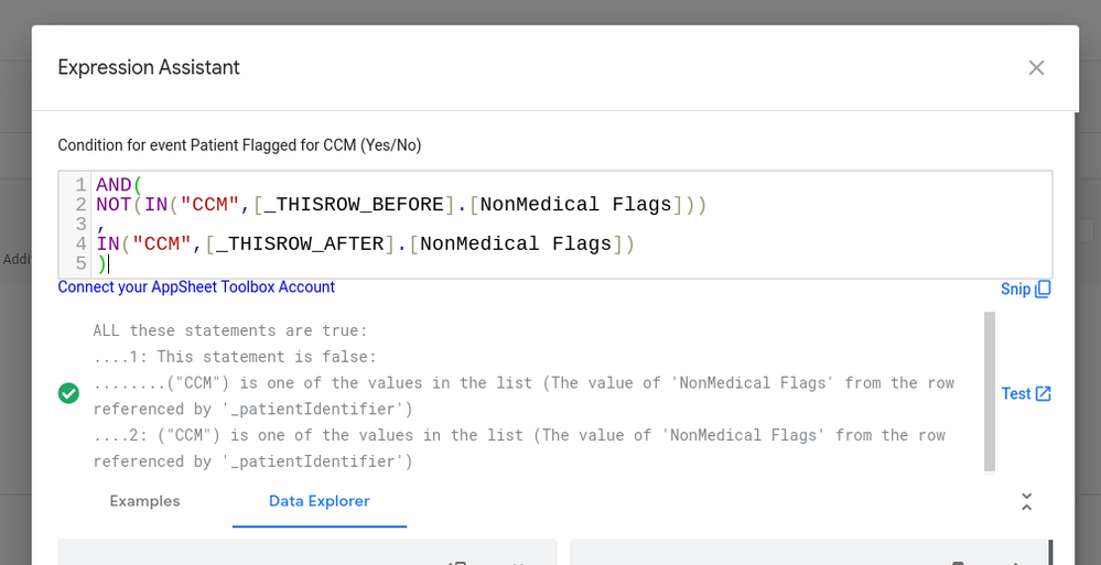

I am trying to create an automation to push a message to Google Chat when a patient is flagged for CCM (chronic care management).
I have performed similar tasks in the recent past but am not sure why this one seems to not be firing off.
My criteria for the event: If the patient was not previously flagged for CCM but that flag has been enabled (the column is [Nonmedical Flags] and is an enum list, currently set to Quick Edit on the view in question), trigger a webhook to facilitate the chat menu.
My condition looks like this:
AND(
NOT(IN("CCM",[_THISROW_BEFORE].[NonMedical Flags]))
IN("CCM",[_THISROW_AFTER].[NonMedical Flags])
this looks correct to me, but when i check the Monitor, i don't see the automation being triggered at all.
what am i missing here?
0 6 234
Figured it out.... I failed to terminate my JSON string properly 😂

i have it set for All (add, update, delete) but it's not triggering to where i can even see it in the Monitor option. Does the filter condition look okay? Is there any reason why that would not properly be detecting the change i'm looking for ?
I've had a few issues in the past with quick edit columns causing issues, could this be one of those?
I do not see any logic or syntax issues with your expression as a Condition on a Bot.
If you haven't already, check all the easy things - make sure the edits are getting saved,  make sure the Bot references the correct table, make sure the Bot is enabled.
I don't recall ever using  a QuickEdit to trigger a Bot.  I believe it should work. To test if the QuickEdit is the problem, create a Form with only that column and test performing the Edit through the Form.  If the Bot still doesn't trigger then a closer look is needed at the process flow.
I just tested using an EnumList as a QuickEdit to trigger a Bot that sends a simple email.  It is working for me.
