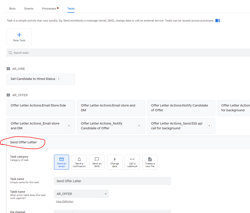

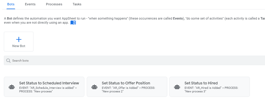

I have created my first and only 3 bots so far. My one word description of the process is “Tedious”. The reusability of each item in automations means -2 for a single purpose simple app or even one that is complex but linear in functionality. Creating these 3 bots easily took 2-3x longer than making equivalent workflows and you can see that I didn’t bother to name the processes cause the ability to name them doesn’t come about in the standard ordering.
Might just be personal bias but I really dislike having to make a task of an action. The change data task type doesn’t give you any extra functionality except you get to type the name of your action in again. If you could export the audit logs then it would make some sense to give a distinct name for analysis but that doesn’t exist so I see not one reason to name the task anything other than the name of the action it is taking.
When you go into the Automation tab it will automatically switch to the preview to the settings tab but when I go back to the UX or data tab it does not re-open the preview. Just a personal bother whenever I am going back to editing the UX. Plus it has to sync the app again so I can only imagine those with long sync times.
When you first create a custom step, it does not automatically select that step to be edited.
Would be great if I could start typing to search through my tasks for when I have 20 of them. Or at the least if they were sorted alphabetically instead of whatever sorting method this is. Also don’t know why there are doubles of my workflow tasks with one : and one _
