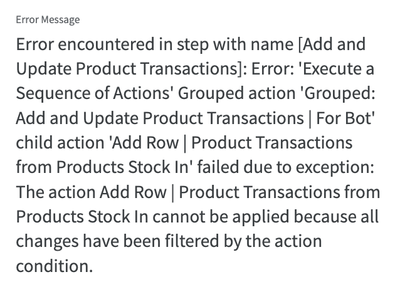

It seems that now Bots are failing when there's an action with an "Only if this condition is true" condition configured. If the condition's expression result is FALSE, instead of just omitting launching the action as it has been the case since forever, AppSheet servers now exhibit the following behavior:
  1. Actions launched on the device, i.e. through an action button, behave normally.
  2. Actions launched through Automation, from Bots, fail with an error when the condition is not fulfilled.
  3. What is fatal is that the WHOLE Bot fails and all subsequent steps in the bot's process are not executed, generating all kind of data errors you can imagine from Bots in limbo that had neither stopped from running nor completed, but simply stopped in the middle ruining all kinds of workflows and data checks you had put in place to ensure production data sanity.
The problem was reported to me from everyone on Friday, and I spent the whole weekend day and night replacing all of the these bots.

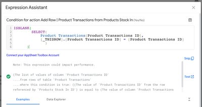

This is insane ! Not sure who is developing this kind of logic. I have a grouped action in automation. First action checks if Child Rows are blank or not. If not blank then it will trigger the second action.
Action 01
Action 02
Here Action 01 and Action 02 are just inverse and 99% of the time the Action 01 is FALSE.
If Action 01 is false it must trigger Action 02 but It just stops and fails as shown in automation bot error. That means 99% of the time my bot stops after checking first action inside grouped action.
