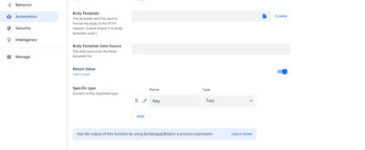

I would like to know if there is any way to use a return value, as a confirmation??
In this case I am sending a list of tools that the collaborator receives in the form of a loan and I send that information with a confirmation button. Can you set a column in the record from where this stream comes out and set a value in that column before the response?
In the meta for developer section there is a section where it says that: to configure alerts when you receive a message or when the status of a message changes, you have to configure a webhook endpoint for your app.
In my automation I have found the section to set a return value, but I can't find what Meta asks me to send that return value. Nor is it understood in the information how to use that return.
If I want a value of a column for the record that activates this flow to change its value based on the response, how do I do it?
You would need to dynamically edit the record asociated with the confirmation using the AppSheet API
