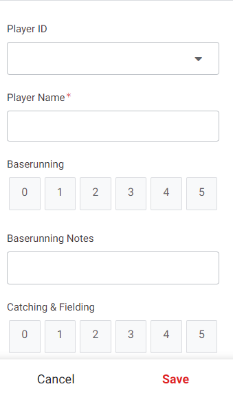

I'm working on an ease of use project. Right now, my form looks like this:
The Player ID dropdown is populated suggested value "players [player_key]" (pull the ID list from the players table). When the user selects the ID from the drop down, the Player Name field auto-populates using AutoCompute / Initial Value of "LOOKUP([Player ID], "players", "player_key", "_PlayerName").

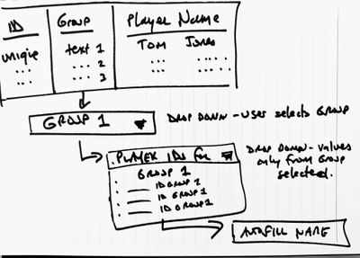

The list of Player IDs has grown (its over 500) and I'd like to present them to the user by Group. So I'd like to add a new field that says Group, that when the user selects a value, autopopulates the Player ID dropdown with only the IDs related to that group. And then, when the user selects that value, the Player Name field autopopulates as it did. Something like this:
(sorry for crude drawing).
Any suggestions? I am getting stuck because the ref between players and evals is the unique ID, and not the Group, so I am unsure how to link the Group and Player ID field together with logic that allows Group ID to direct the Player ID values, and then trigger the autofill of the name. I have searched this forum but have not found a use case like this that works.
