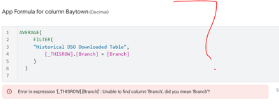

I have a table and I need to build a Virtual column with averages.  I need an average of column [DSO] based on two things:
Date [year] = "Current year" ( I already have a virtual column "year")
Branch [branch] (I have 7 different branches PLUS my "Total" = so It will calculate 8 Averaged DSO)

Thanks Steve,
I am still not getting this (see below):
This happens to me when I'm using a slice that doesn't include the column. Make sure that Historical DSO Download Table includes the Branch column.

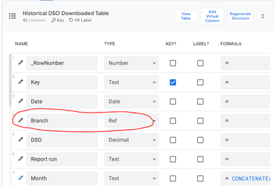

It does, but it is a Ref.  Is that the problem?
What about the table that includes the Baytown column?
Got it working.  Thanks AGAIN Steve!
