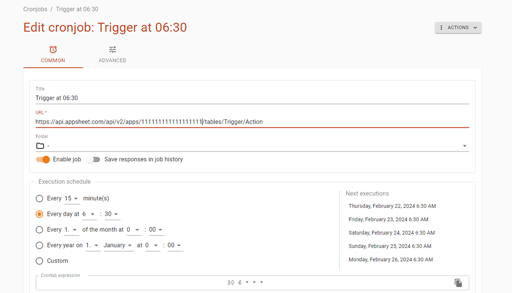

Instead of Appsheet Scheduled BOTs you can also rely on external services like cron-job.org to call the Appsheet Action via api

What i meant is you can trigger the condition for BOT using an action say a data change action using the external api call
Oh true, just need an extra increment column whose only purpose is to trigger the bot. Thanks for the input i think i'll go on with that!

this is how I set-up cron-job:
URL: https://api.appsheet.com/api/v2/apps/{appId}/tables/{tableName}/Action?applicationAccessKey=<applicationAccessKey>
Method: POST
body:{"Action": "BOT_Trigger_execute_action"}
When I test it, i have this error: 415 Unsupported Media Type
Not exactly
URL : https://api.appsheet.com/api/v2/apps/{appid}/tables/{tablename}/Action
In cron-job Advanced Tab you have to mention the following headers
and this is the body
"Action": "Edit",
 "Properties": {
    "Locale": "en-IN",
"Timezone": "India Standard Time"
"Rows": [
"ID": "1"
This is brilliant, thanks for sharing
