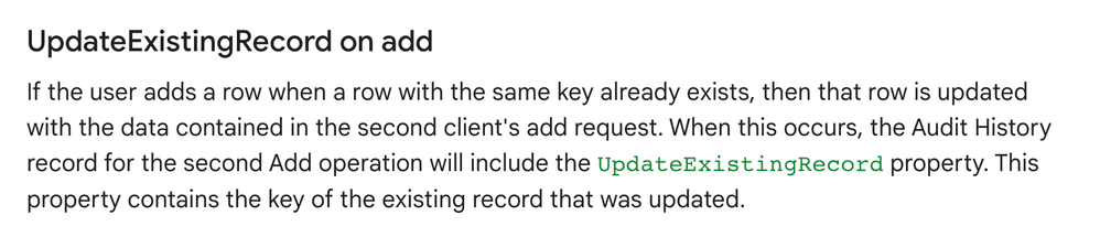

Concurrent usage with multiple users - AppSheet Help
I assume you are providing this article to imply that AppSheet DOES allow rows with duplicate keys - when it is two different users?
That actually is not the case.  Each user is operating in separate distributed environment.  At the time the rows are INSERTED, in those environments, AppSheet has no knowledge of any other rows with the same row key.  Each mini-environment still meets the core principle of only a single row key.
When these distributed mini-environments are merged/Synced back to the server, the first occurrence INSERTS and the second OVERWRITES - at least I hope that is how it is being handled.  Core principle is still intact.
Maybe you are referring to this section:
This is what I EXPECT...BUT it is NOT what's happening.  If I perform an ADD action and provide an existing row key, a SECOND row is being INSERTED with that row key - at least when this add is performed on the client/device side.   I can actually visualize these two rows in a view for a brief few seconds - as indicated in my original post - though you cannot see the row keys.

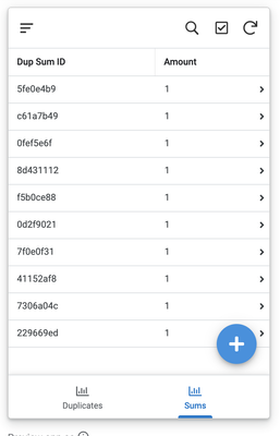

For what its worth,  I ran the exact same Looping action demonstrated in the video above but now triggered by a Bot.  The end result is just as I would expect.  Below is an image of the resulting Sums where on each iteration the SUM was 1 as expected.
For those who haven't seen the video above, when this same Loop action is run on Form Save, the "Sums" table has incrementally increasing sum amounts because the Upsert is inserting dup rows instead of updating the existing row - leading to increased SUM amounts.
Bottom-line...it appears the Bug I have outlined is only on the client/device-side.
Running Upsert iterations on server yields expected results
