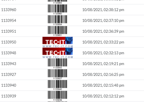

Barcode showing TEC-IT Logo
We use the tec-it url to create barcode images in apps
e.g. https://barcode.tec-it.com/barcode.ashx?data=1133950
We’re getting a few instances of the barcode not showing and the TEC-IT logo showing instead
this logo shows on multiple devices, syncing doesn’t sort it.
When I click the link from the google sheet where the data is the link creates the barcode image.
Does anyone know what may be happening?

Do you have the links in a Virtual Column?
I’ve seen this before, and I believe what causes it is that the tec-it server is receiving too many requests in too short of a time. If you have the links in Virtual Columns, that means your app is trying to re-load all of your images at once upon every sync. I’d advise you to keep the links in real columns so that they load far less often, and only one at a time. Even better is if you can download each image to your GDrive and directly reference the file.
The links in the app in the image are a real column.
That app is synced after each barcode is created, so does that mean it requests every barcode each time it is synced, or does Appsheet store the image?
Some other apps use virtual columns for the barcodes.
These only show in the detail or form view.
Is that the point it requests the barcode? It seems to be as they load when the view is opened.
The barcodes are created when they select the order.
Is there a way to download them to GDrive at that point? And then I guess I’d need to change the reference from the tec-it link which creates the image, to the GDrive location.
Thanks for your help
I was on the wrong track a little on my last post. The real vs virtual simply affects the creation of the URL value that is stored in the column. I’m not sure when the request to tec-it happens to load the images. But it is either:
  1. When the app first loads.
  2. When the user navigates to the view.
Appsheet will also try to cache the image at some points, which is why the tec-it image might stick around for a bit.
Then there is this option to play with:
Your example screenshot above is neither a Detail or Form though.
I’ve used a Google Apps Script to download the images and store them on GDrive, as well as update a cell in the sheet to reflect the new relative path.
Store for offline use is turned off in the app.
But maybe appsheet is still caching the images, which would make sense why the logo sticks around.
Maybe I’ll make the app in the screenshot store images, then it won’t request them every time it’s synced (if it does now)
The virtual columns are in detail or form views.
The screenshot is from the app that has the links in a real column.
It seems to have been working ok today, maybe they were getting lots of requests from somewhere else that affected our requests.
I’ll keep an eye on it to see what happens.
