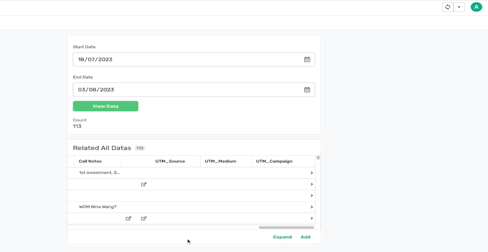

I observe real-time updating of slices, which filters out rows based on date input. However, when the same slice is used in a virtual column of the output table, it takes time to recalculate. This creates a situation where users see the change in the number of rows in the slice and assume that the COUNT data in the virtual column is correct, relying on that value. In reality, the values have not yet been updated, leading to user confusion and questioning the integrity of the data shown by the AppSheet application.
Here is the issue

This VC directly in the My User Settings table also waits till its synced.

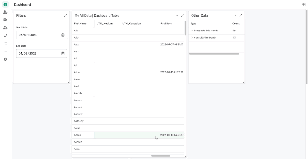

I wonder when the slice with above condition clearly filters out all rows in real-time and VC is still waiting for the sync. Puts users in total confusion like shown below. Not sure what to do now.
@Rifad wrote:
Here is the issue

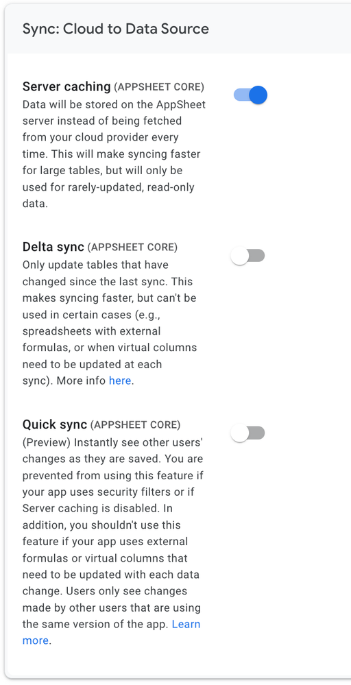

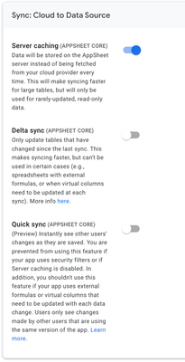

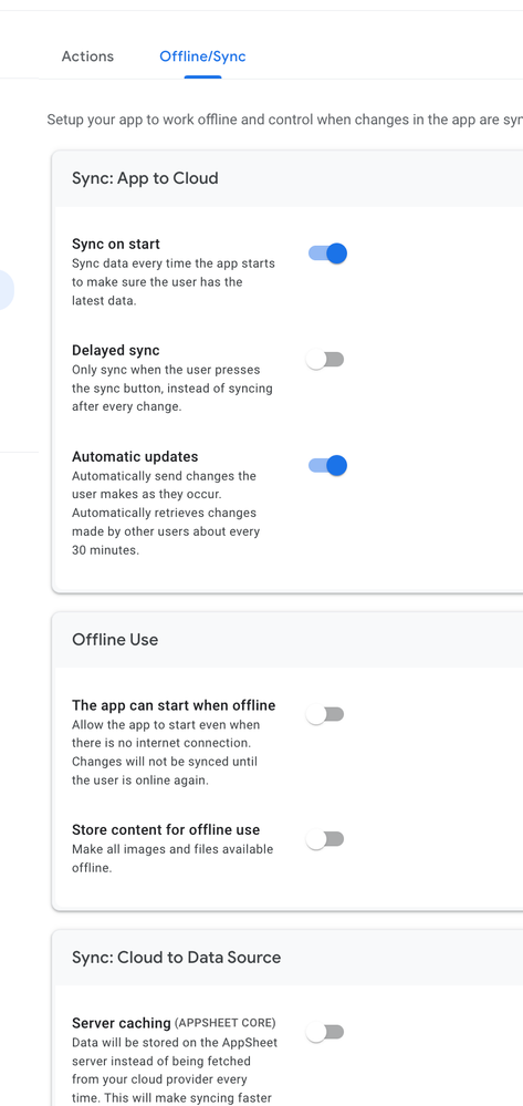

I'm not facing this issue, but I remember long ago that I faced issues with VCs when I had Delta Sync enabled, so just in case check it.
Also, here are my settings, try to match them and test please. Otherwise we'll figure out a solution.
Capture dโ€™eฬcran 2023-08-03 aฬ€ 09.12.42.pngCapture dโ€™eฬcran 2023-08-03 aฬ€ 09.12.28.png
The app is configured same way as above and the delta sync is off @Joseph_Seddik
Turning off Delta sync helped my virtual columns to recalculate quickly when pulling data from other tables. Thanks

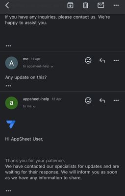

โ€ƒAbsolutely no help from support these days and 90% of time we get a copy pasted message like this. I just wanted to confirm if its a bug or intended behaviour and this is the message we get after 6 days.
Just wanted to confirm appsheet team is most incompetent support team in this planet assuming google being one of the biggest company is nothing other than a marketing gimmick.
Last email was sent 3 months ago. Ticket was open almost an year ago.
@devingu It will be helpful if someone can at-least check and acknowledge if its a bug or not. Its been 12 days my client is being kept on hold. Its showing wrong data until app is synced. I have shown all required details above in this post. Theres absolutely no resolution other than copy pasted messages from support. Here is the case id  [1-3939000034861] .
