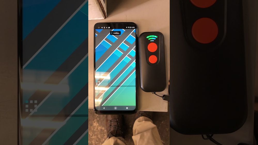

Here is the behavior that is strange. While we are in the app and have done some scans, the Bluetooth barcode scanner can go to sleep; pulling the trigger wakes it back up and reconnects the Bluetooth. During this period, with no intervention on the tablet, the App will restart and resynch (but not transmit data) and the go back to where it was when the scanner was reactivated.
Is this expected behaviorโ€ฆthe App restarting when the Bluetooth scanner is reconnected during the operation? It seems no matter where the app is, ready for a scan or at any point in the app or even the ADD screen where there is no input, the app will restart and come back to where it was before the restart.

I need to add to Daisyโ€™s post. Our bluetooth scanners timeout after a certain time and when the bluetooth loses and regains connection it causes appsheet to reload. After gaining the third reconnect we lose all Form View Data and Appsheet goes back to Table View. A workaround is to have the barcode scanner not timeout after 1 minute but not all barcode scanners have that functionality.

Mobile Device is Moto G Power with latest Android update
Device is the one you see in the post above but the action happens with one other Inatek device we have.
