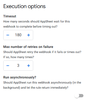

As to why it is being triggered twice after failure/timeout, I'm not sure. The 'call a webhook' task type comes with these options:
I feel the same options should be available for the 'call a script' task type. Who knows what the number of retries is set to...
