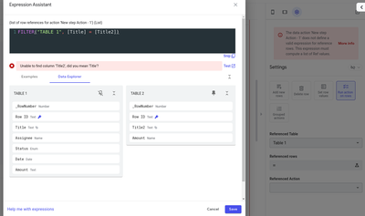

What I tried here is to filter the "Table 1" entries where the "Title" on "Table 1" has the same value as the "Title2" column on "Table 2", which is my Event row. (call this bot every time a new entry is added to "Table 2")

This is not particular to automation, it's just because you are using a Filter expression
I've tried thisrow already, but it didn't do much difference. Pretty sure I'm missing something here.
The event is fired on Table 2, right?
Yes:
Make sure every part of your automation uses the same table:
Ok, gotcha. The problem here was the data source been using. I was using the new AppSheet database featurewhich is still in beta. I redid the exact same application using Google Sheets and the automation worked as expected, with no errors. I think I gotcha a bug here.
